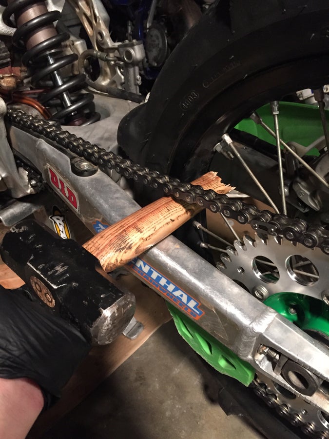

How the heck do I loosen it? I'm practically jumping on the breaker bar and it still won't come loose. I've only got cheap air tools and they don't have enough torque.

K thanks. I've got a harbor freight 1/2" impact and it doesn't even come close. my guess is I've put 500 ft lbs of torque on the breaker bar. The nice 1/2" impacts do about 1000. I'm either gonna buy one or take it to a shop.
And by the way-I put it in 5th gear and put in a sledge hammer in between the swing arm and the spoke/nipple of the rear wheel. Broke the nipple in half and the wooden handle of the sledge... this is like the 10th time I've learned that using the right tool is always worth it

The sprocket stuff sprocket tool is your friend here,no need to risk breaking spokes etc

Cool thanks for the info. Yeah I definitely need a good impact. I bought the sprocket holder tool and used the breaker bar. Bent the aluminum holder. Wish it was made of steel...

If you go with the breaker bar method, then put an alum rod (1" thick") through your rear sprocket with rags to protect your swingarm. The rod might bend and the breaker bar needs to be over 6ft long, but it should work.  Or get a cheap rattle wrench. They're amazing.

Looks like you have a nice big paddle tire. Put a bar on the swing arm and let the paddle hook onto it. Either rip a paddle off (not likely) or break the nut loose.
