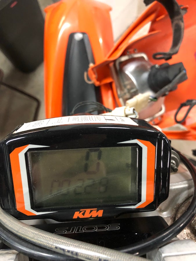

Not sure how well it will do at altitude but we are headed to Taylor Park reservoir in August. I went two years ago with my inlaws and had a blast. Don’t flame me but I took my Polaris General. I have seen the light and want to bring two wheels this time. I figure I have 6mos to get myself and the bike in shape. I am open to suggestions for a bike a little better suited for the area but will definitely keep and get the 200 in good shape. Put a new battery in the speedo and shows 23 hours and 320 miles. IMG_0445.jpgIMG_0446.jpg
