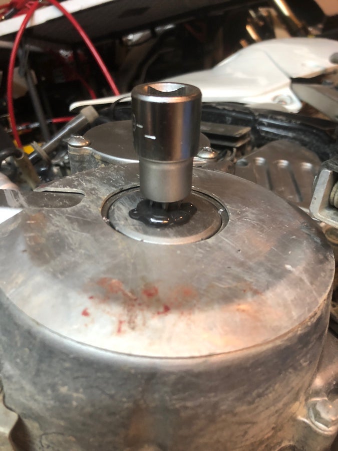

The breaker bar worked on my original case i put a hole in. The one on the bike is a used one. The torx is slipping, i need to pound it in harder and probably JB weld. The one off the bike popped right off and i had the same issue on the bike. It was almost stripped too.
remove cover , screw 2 self tap screws in nut , grab both self tap screws with a long nose vise grip , twist .
Damn all you guys trying to make me actually do some work and take the cover off. Not before i exhaust all lazy options! That will be plan C, here’s plan B

My buddy threaded a bolt in there, came out ezpz.
