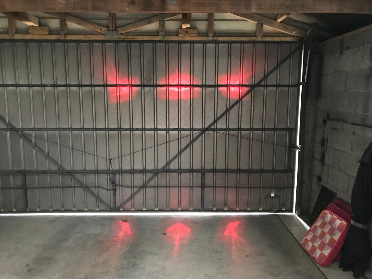

Also there are 6 red LEDS that shine out the main beam hole when you illuminate the running light.  Its illegal where I am to have these going with bike running.  I wired mine into the park setting on the key switch this means that the bike can't run when the "park" light is on, but it can look cool in the carpark.  I used an automotive relay to break the circuit when the main light is on so that the red light can never shine with the bike running.
