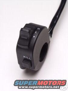

Thought I would share some photos of the KLX 450 headlight I installed on my son's KLX 140. The brackets are made from 14 GA S.S. and the new light switch I puchased off of E-bay. Enjoy.

The power for the headlight comes off the back side of the run/stop switch then runs through a 5 amp fuse to the off/low/high switch for the headlight. Both the high and low beam run at 35 watts and at 12 volts is pulling 2.9 amps. The battery is rated at 6 Amp/hr which means that the headlight theoritically could be left on for two hour before the battery is completely dead. I have not been able to find out the power output of the stator, but I figured that if the Baja Design kit that is available for the bike runs a headlight with out a re-wound stator, then it should be OK. We will have the bike out over New Years and I will report back if I encounter any problems with the charging system.

I did have to do some minor rewiring at the front of the bike to get the headlight to work. I replaced the start button with High/Low/Off headlight switch that also had a kill button (momentary) built into it. You can see the swithch in the original post, it is next to the throttle. I used the hot wire that powered the start button to operate both the headlight and the new start button(kill button) on the new switch assembly. I installed a 5 amp in-line fuse on the power side of the headlight switch to protect the rest of the electrical circuit. Then hook up the high and low beam wires from the KLX 450 headlight to the appropriate wires from the High/Low/Off switch.
It is easier done than said. Let me know if you need a wiring diagram as that may be more clear.
The light has been on the bike for over two years and we have never had any problems with it or the charging system. It has even survived a few tough crashes.

Here is the wiring diagram for the KLX 140 that I used to hook up my headlight and a picture of the new headlight switch.
https://www.supermot...ight-switch.jpg
