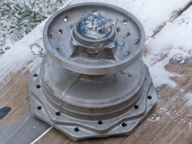

Here's my replacement clamp, you can see where I sanded, then hit it with the soda. It's clean but it doesn't look "factory".
Even the soda still left some staining.
I could easily polish this to a mirror finish but it wouldn't look correct. After playing with a few things I found grade 0 steel wool cleaned it up and gave it a decent amount of luster not to be overpowering.
Looking good jeekins. The true blasting soda may be what you need to get rid of the shine.
I read somewhere that baking soda works so well because the grains/particles burst on impact, thus taking away any gunk away with it.
Mine is working really good at work where theres a constant 120psi, I just go through the media really quick now! It cleaned up the caliper I posted earlier.
